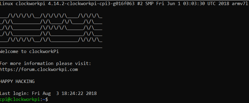

First you’ll want to ssh into the Gameshell from your favorite terminal. Once you do that, you should see this:
